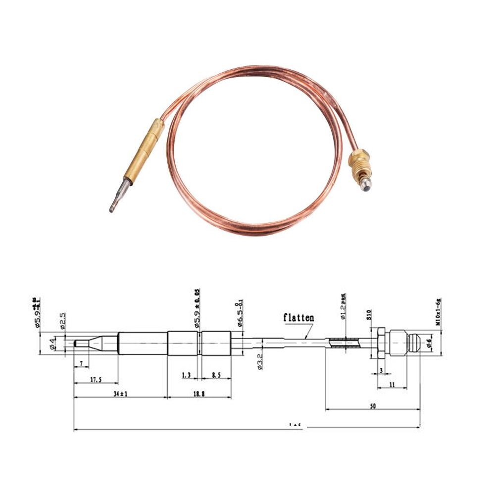

[hide][Immagine: https://images-na.ssl-images-amazon.com/images/I/512KNvwagnL._SL1000_.jpg][/hide]
