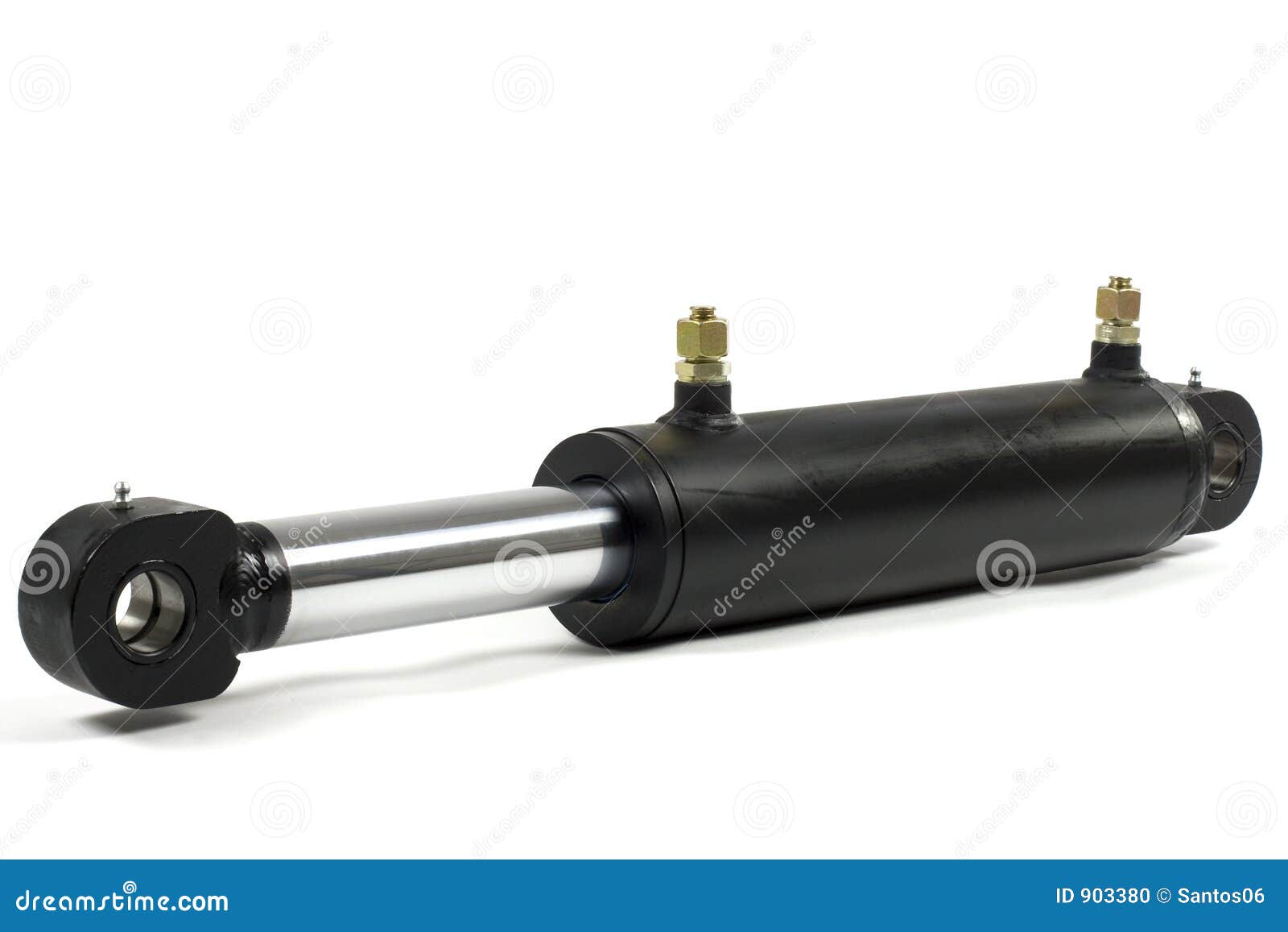

[hide][Immagine: http://thumbs.dreamstime.com/z/cilindro-idraulico-903380.jpg][/hide]
42Big Grin42
